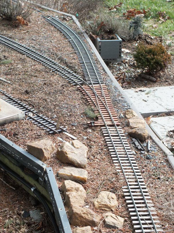

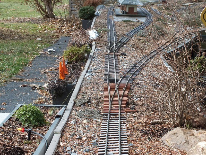

Back in October while at Andy’s ops session, Bruce had about 5 switches he wasn’t using anymore. He couldn’t remember whose switches they were, but the were in good shape but needed the ties replaced. Being the swell fella that he is, he donated them to the Rio Grande Southern. After replacing most of the ties on them, I knew of a few places out on the layout where they could be used. The 1st 2 spots were right outside Delores, the one for the run around and the other for the wye.
The next spot was the run around going into Mancos.

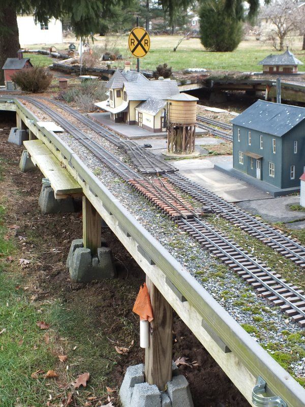

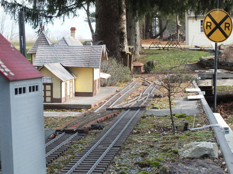

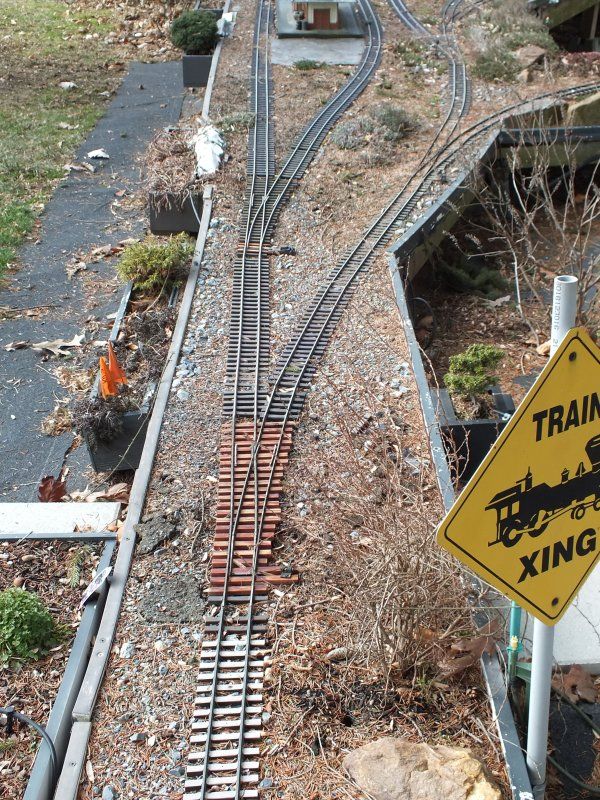

That left 2 more switches to decide what to do with. Something I had been pondering was an escape track down in Porter on the interchange track.
Another place I thought about was on the Wye tail track.
But I couldn’t think of a good reason why I would need it on this side. The Interchange seemed more logical.
Yea, I like this side better. Less busy than the other side. Now for some half decent weather to work on this. It should be in by the Ops session in April.

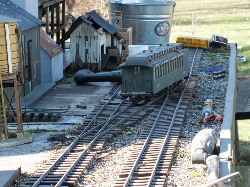

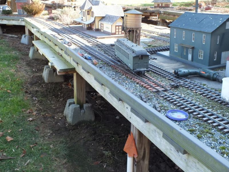

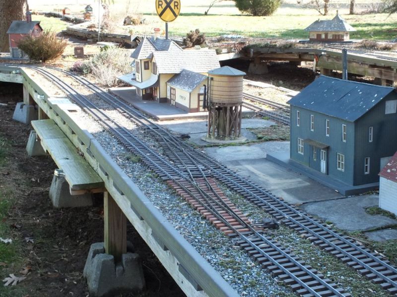

Success!
Finally had a half decent day weather-wise and decided to work on these switches.
Ran my largest passenger car through them without a hitch(which is a first)!

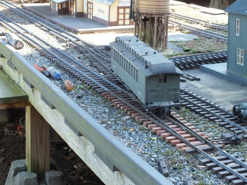

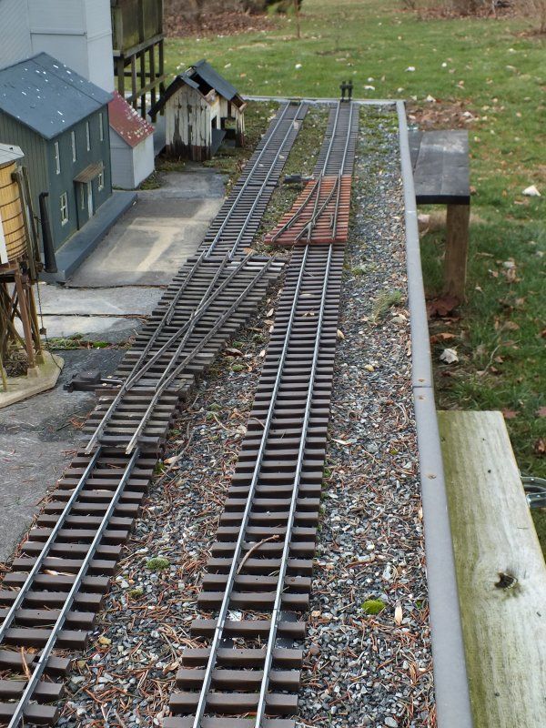

Ken,
These last pictures illustrate the issue I have with your switches. the new one from Bruce has a smooth transition (read curve) from the points to the frog. most of your switches are like the one on the other end of the crossover, in that they have an abrupt bend at the points, which dosnt lend to the best operation. the end of the points should only be about 5/16" from the stock rail at the point they connect to the inner rails. yours are close to 3/4 from the pictures.
Me, I do not have any pictures yet, but have been heavily invested in pink foam / dust on the indoor portion of the railroad, with the idea of finishing the scenery. too much frozen white crap on the ground to do anything outdoors here.
Al P.
I understand what your saying, Al. It’s something I’ll have to work on.
As for the points, that’s where the B’mann throws set them.
Ken, I noticed that, and I don’t think Al’s talking about the amount of the throw from the point lever. The attached pic shows what I think he’s referring to. (I don’t have a problem with the adrupt bend, and if your trains don’t mind then who are we to comment!) (http://www.largescalecentral.com/externals/tinymce/plugins/emoticons/img/smiley-cool.gif)
I think one of the reasons why I was doing it that way was to save a lot of grinding down on the stock rail and the point rails so the points would fit snug.
Well, yes, you did save a lot of grinding. But there’s engineering reasons that most point blades are finely tapered (http://www.largescalecentral.com/externals/tinymce/plugins/emoticons/img/smiley-cool.gif)
I think it was a literal translation of a Numbered switch description. How often do we say that only sectional track switches have curved rails and numbered are straight through the frog? We should be saying Straighter to the frog, but still curved from the stock rail to the frog where it straightens unless topography demands a curve.
